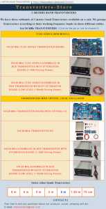

#362445  - 10 mayo, 2021 12:38
Publicado por: @ea1cn .... https://transverters-store.com   ....
Gracias por compartir la informacion de la web  de los Transverters de Ukranian UT5JCW
1 Transverters UT5JCW
También esta en EBAY https://www.ebay.com/str/transvertersstore
2 Transverters UT5JCW
· Parece ser que el TARJETA TRANSVERTIDORA SERIE TCXO DE 144/28 MHZ
es una versión mejorada con "144/28 MHz TCXO SERIES Transverter Board"
This NEW MODEL TCXO SERIES of Transverters contains SPECIAL ORDERED SMD type of TCXO with +-1ppm stability. It makes this Transverter especially good for Digital Modes operation. Additionally we added the narrow two coils Band Pass filter of the LO frequency that more suppressed unwanted emission. TCXO pic is below
With this transverter board you can work on 2 meter band using any type of HF radio that has 10 meter band. It would work the whole 2m band at 144 to 146 MHz if your base radio has 28 to 30 MHz band. It works any modes such SSB, CW or FM if its available in your radio.
This NEW model of 144 MHz Transverter board allows you additionally use the separate RX/TX outputs of your base 28 MHz radio.
Driving this transverter board by 1 to 50 mW (0.05 W Max) from your 10m band radio you get about 10 - 15 W output power on 2m band. You can adjust input driving power by RV1 pot on the board. This low level input driving power allows to use this transverter board through the low level transverter output of HF radios or with Flex Radios and other type of SDR Radios.
If you are going to use this transverter board driving it by 1 to 10 W power through the Antenna Output of your radio then you would additionally need the Attenuator Board.
Some hint... In my other listings you find the Attenuator Board along with the Transverter Board for a lower price than buying them separately.
We are offering completely built and tested in our lab board that comes with the English description which contains the circuit diagram of this transverter and circuit of a simple attenuator board.
Technical specifications
RF range - 144 ... 146 MHz
IF range - 28 ... 30 MHz
IF input power - 1 ... 50 mW / 0 ... 17 dBm (0.05 W max.)
LO frequency - 116 MHz (116.000 MHz SMD Type of TCXO)
LO frequency stability - +/- 1 ppm
Output power - 10 ... 15 W
RX gain - typ. 20 dB
Noise figure - typ. 1.0 dB
Image rejection - typ. 70 dB
PTT control - Contact closure to ground
Supply voltage - +13.8 V DC (+12 ... 14 V DC)
Current consumption - typ. 1.3 A (TX)
TX Output transistor - RD15HVF1
RX Input transistor - BF998
Dimensions (mm) - 80 x 45
73 Carlos EC1T
