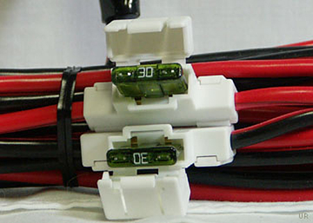

Leo en web de N9EWO que ICOM a sustituido el Cable DC de alimentación "OPC-1457 DC Power Cable"
con un nuevo portafusibles de color negro, el que daba problemas era el de color Blanco.
(N9EWO photo left)
Icom made changes to the OPC-1457 DC cable as shown above. The fuse holders were changed along with 2 added "unknowns" (Adam VA7OJ says EMC filters perhaps ?) in heat shrink tubing. This change was made due to RF "Transmit" power dropping off (or radio totally cutting out) due to oxidized-dirty fuse holder connections. The fuse holders on this new improved cable fit MUCH tighter. (N9EWO photo left)
Protafusible nuevo color negro
