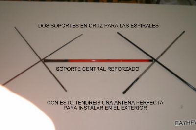

[img size=400] [/img]
LOS DE DECATHLON... APARTE DE TENERLOS "INTRIGAOS", YA ME TUTEAN...
HI HI
