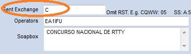

Yo tengo las macros para llamada, reporte, confirmacion etc.... el tema es que la macro de confirmacion la queria cambiar de forma que cogiese el numeral o la matricula de la provincia de cara al concurso de RTTY y no se como hacerlo,
Mi macro de confirmacion es:
{TX}! TU GL de *, QRZ? EATEST {RX}{LOG}
Traducido al "cristiano" y usando tu indicativo, esta macro te añadiria en el log y te mandaria:
EA7KP TU GL de EA1IFU, QRZ? EATEST
Lo que me gustaria hacer es que mandase
EA7KP CFM (AL), GL de EA1IFU, QRZ? EATEST y mi duda, por que no lo se, es como hacer para que la matricula que tu me pasaste la coja para enviarla, la macro quedaria:
{TX}! CFM (???),GL de *, QRZ? EATEST {RX}{LOG} con la duda de que comando usar en lugar de ??? y que coja tu matricula o el numero de control en caso de estaciones no EA.

Perdón por la metedura de pata, lo he encontrado!, y ahora entiendo lo que quieres.
Why isn't there a macro to repeat the other station's exchange back to him?
This is not supported in N1MM Logger because the practice is considered inefficient, ambiguous and error-prone. The only exchange-like thing you should be sending to the other station is your own exchange. In perfect copy conditions, repeating his exchange just wastes time. On the other hand, if copy is poor sending something other than your own sent exchange but that looks like an exchange just invites confusion ("Let's see - I just sent him 2A OK and now I see a 2A OH back from him in the middle of some garble; is he telling me he copied my exchange incorrectly as 2A OH, or did he copy it correctly but it's the message he sent back to me that got garbled, or is that his own exchange he is sending to me? Does he want me to repeat my exchange or not? Do I need to ask him for a repeat of his exchange?"). If you believe you have copied his exchange correctly, send an unmistakable QSL message so he can get on with it and complete the contact; if you are not sure whether you have copied it correctly, send an unmistakable AGN? message to ask for a repeat. Don't leave him in doubt.
O sea que no se puede.
EA1IFU
Mensajes: 79
#273187  - 30 marzo, 2015 17:12
Gracias por la informacion Angel, mira que le divueltas a la traduccion del manual en castellano y no encontre esa informacion. Gracias
el {EXCH} Es el valor que os marco en la foto
