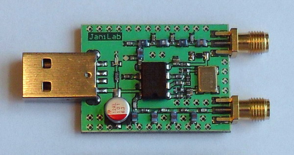

#184213  - 5 agosto, 2012 22:41
Interesante "cacharro"
http://www.ebay.com/itm/HF-Converter-for-RTL2832U-E4000-RTLSDR-SDR-Radio-FUNcube-Dongle-Realtek-Ezcap-/180944821296?pt=US_Ham_Radio_Receivers&hash=item2a2126dc30
Auction consisting of:
1pcs HF Converter for RTL2832U / E4000 SDR Radio Dongle , RTL3832U & FC0013
Local frequency: 100MHz
3.5MHz = 103.5 MHz
7MHz = 107.0 MHz
14MHz = 114.0MHz etc.
Second image antenna input LPF bandwidth
third image output HPF bandwidth
SMA or MCX connector
