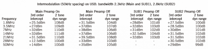

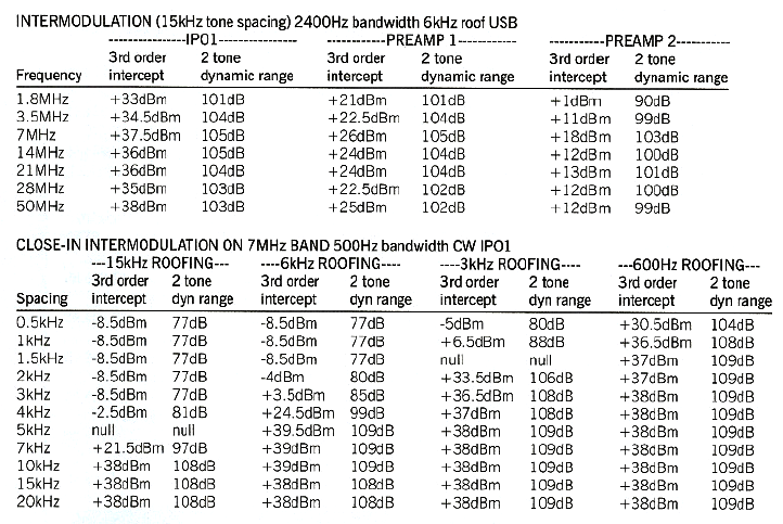

#223674  - 19 mayo, 2013 17:32
Yo estaba esperando alguna comparativa para poder ver un "cara a cara", pero no se porqué ha usado diferentes referencias en uno y otro;
FT Dx-5000
TS-990 S

De la lista de Yahoo sobre el TS-990
El 18/05/2013, a las 04:31, Henry escribió:
One has to take care looking at Peter Hart's reported numbers in
comparing receiver tests to his previous tests and those by the ARRL and
Sherwood.
For instance Hart's MDS is based on a 10dB s+n:n ratio while the ARRL
use 3dB.
For his IMD3 measurements he uses a 50kHz tone spacing (he reportedly
used 15kHz for the FTDX5000 - might be a typo) whereas the ARRL reports
measurements for spacings at 20, 5 and 2 kHz. Sherwood uses a spacing of
2kHz. Hart used a 2.3kHz BW (I think this is the DSP BW with the roofing
filter BW at 6kHz) for the TS990 review (he used 2.4kHz for the FTDX5000
review). The ARRL use 500Hz, normally set by the roofing filter. (The
ARRL also uses a narrow band technique to measure IMD3 to obviate the
effects of reciprocal mixing.)
Hart quotes his reciprocal mixing measurements as dBc/Hz, where the ARRL
quotes them as dBc/500Hz (there is a 27dB difference).
Note also that the ARRL always purchases a random set, whereas Hart uses
borrowed equipment provided directly by the merchandisers/manufacturer -
you can bet it's been optimised. :-)

#223699  - 19 mayo, 2013 19:36
No todo son halagos en ese análisis;
Inband linearity
was very good, but I have seen better.
